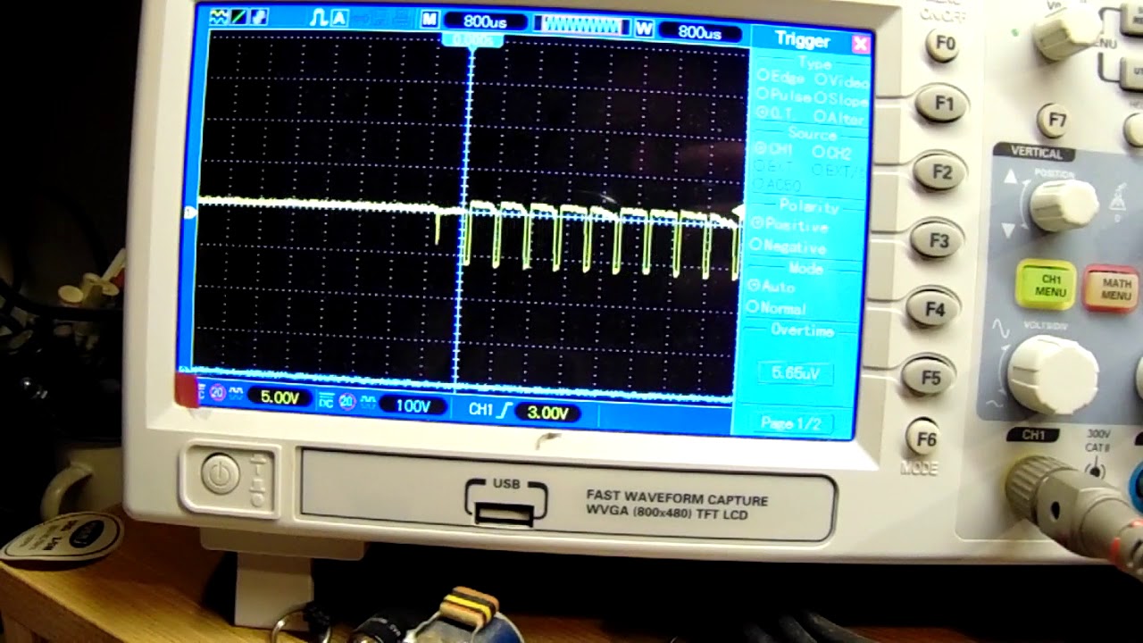

Martin's Taycol Conversion Boards
I know Martin, sometimes I blind myself 😁😁
Anyway I thought 'in for a penny ...', if I'm gonna make the boards then ...
'Wenn schon denn schon' as they say over here 😊
OK. I'll screw the boards into the boxes and put lids and screws in a bag.
I'll leave you to make the cut outs in the boxes for the wires 😁
For the benefit of others here's a pic of the test setup and some video evidence dat de ding woiks 😉 RATS 😡 video file too big, 30MB limit 🤔
Will try another method later.
Taycol Target was running on 6V with current limit set to 2.5A - just in case! All three boards work perfectly using the Robbe Servo tester instead of messing about with TX, RX and batteries 😉
Will now start packing everything, with instructions for the mods to the Taycols.
By the way; do any of your Taycols have reversing coils and that silly lever switch?
Cheers, Doug 😎
