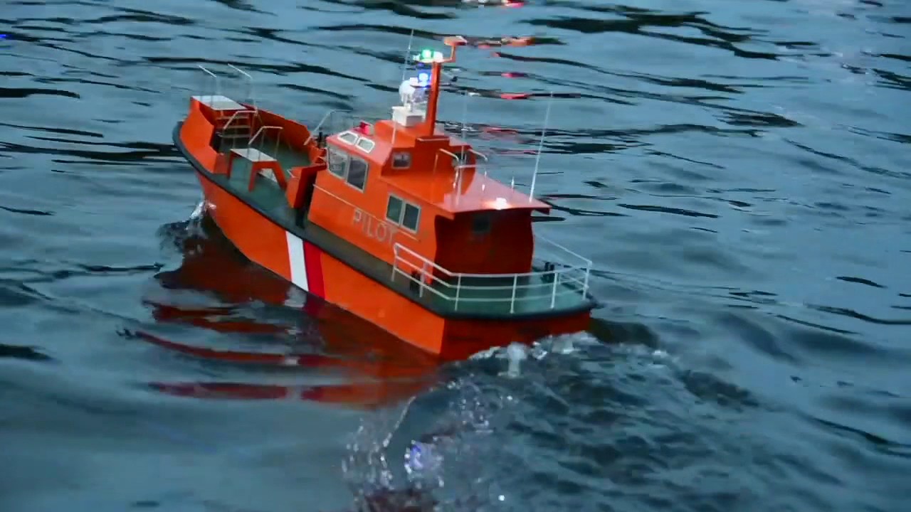

Just watched that youtube clip......pretty good with all the lights on Steve

Yes, I was very pleased with the final model and its maiden voyage. it looks particularly good with all the lights on.
Just a reminder, be very precise when positioning the hull skins and don't use too much glue as the ribs will show through.
