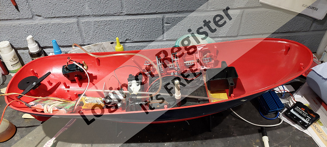

I'm not really a builder, but I love a refurb project, and thought this would be easy!
Day before my grandsons birthday, after a couple of successful runs, I thought give it a final bench test, nothing worked!. Now the deck was silicone to the hull thinking I would not need to venture in there again, as the original thin seal was useless. Took ages to split it apart, water had got in, esc was dead
By now I'm thinking should have just bought a new one, changed the esc, pump now not working either! I had a very fine filter in the water feed pipe, it was blocked. So, started again. Luckily we had a standby birthday present, so pressure was off, but I was disappointed with myself for missing the water leak
It has a water tank in the bottom of the hull that fills once the boat is in the water. It feeds the pump, and acts as ballast, quite clever, this was leaking into the hull when the pumps was operated.
I decided the silicon was a messy idea, so ordered some neoprene seal, it's now all ready for reassemble.
An easy project that has turned into a right pia😁 and too much money for what it is. It had better not leak again, or it's in the bin😮

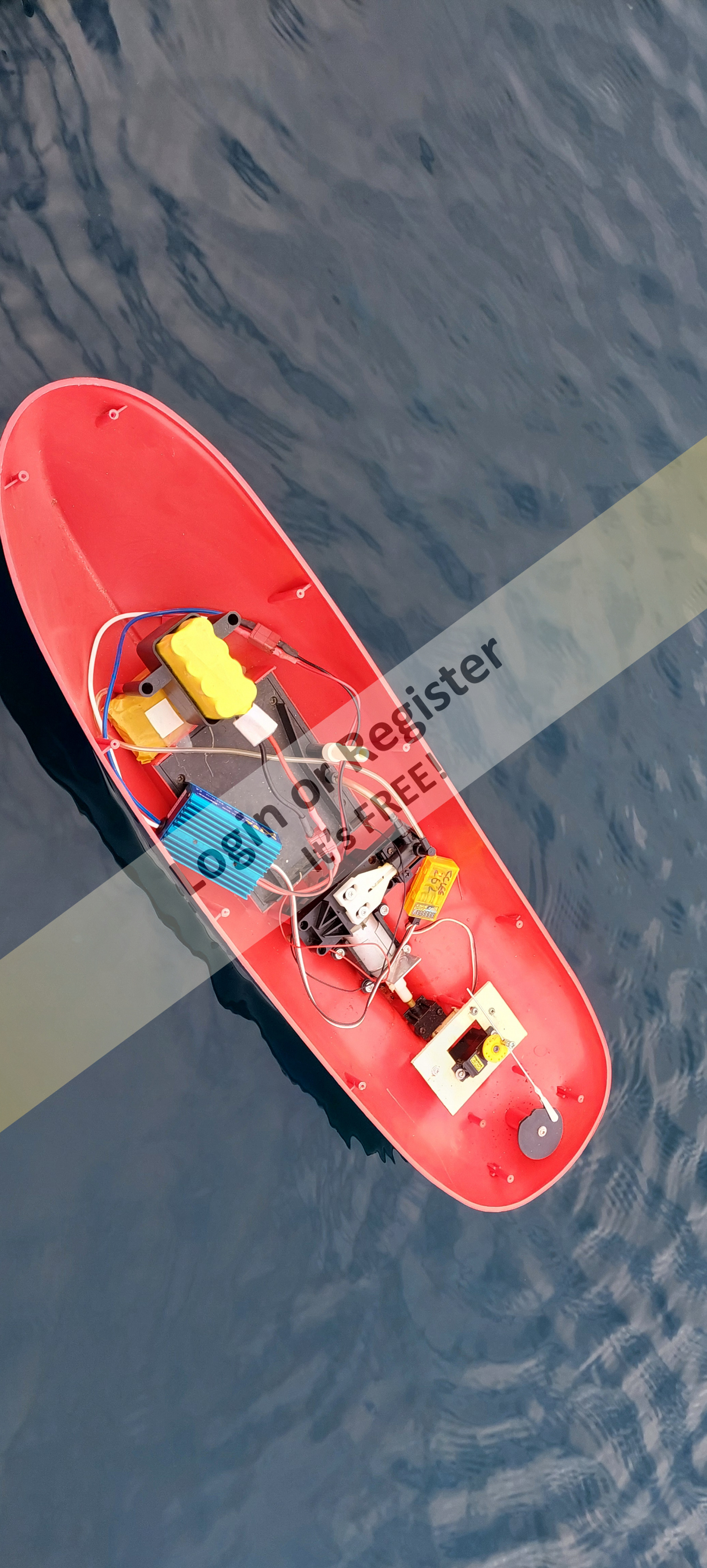

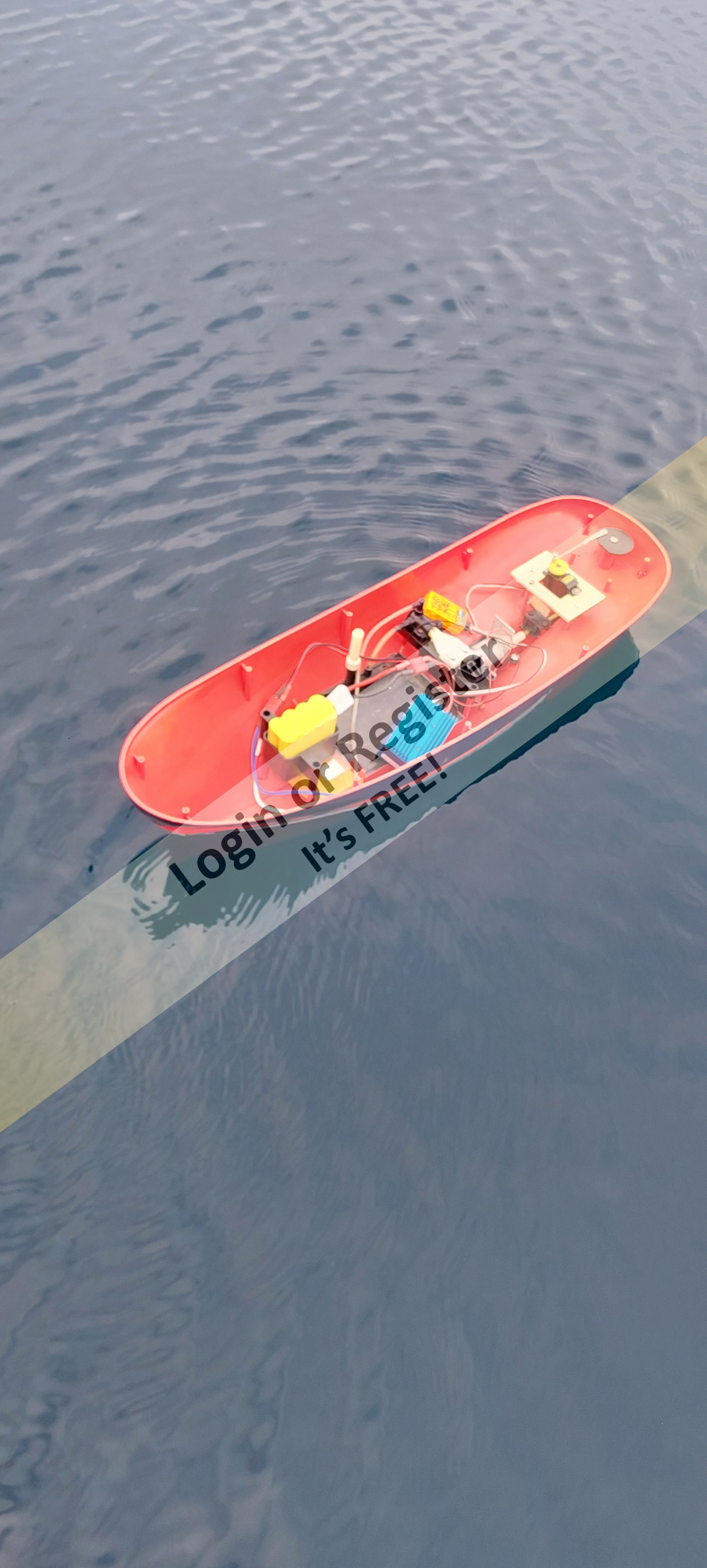

So yesterday I took it to a lake to see what and if it ran, and didn't leak. It went OK, and probably a correct speed for a youngster. I tried a 9.6v nimh, 7.4 v nimh and a small 6v lead acid, and there was no noticeable difference. The lead acid might have been a bit heavy, but would give best run time. I am staying away from lipos because when I'm not there, there is a potential for over discharging.
The water pump makes a lot of noise, but it doesn't pump, unfortunately, and the transmitter isn't a done deal. The throttle range wouldn't set as a none running centre stick. Reverse was useless, I wonder if I can alter the esc settings.

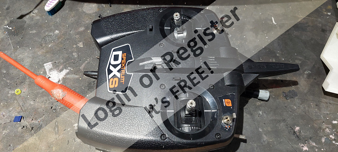

Sorted the transmitter to have a sprung centre throttle stick on left. This was an aero transmitter, so would not have a reversing throttle. It was surprisingly easy once I worked out all the springs etc where there, they just needed to be adjusted. Using same principle, I was able to lock the up/ down if the right stick, do only now have left right for rudder. Got the rudder working with some mods, someone else has been in here so everything needs checking👍

😂......its a screw driver.......🤣
#2 2
Dickie harbour tug

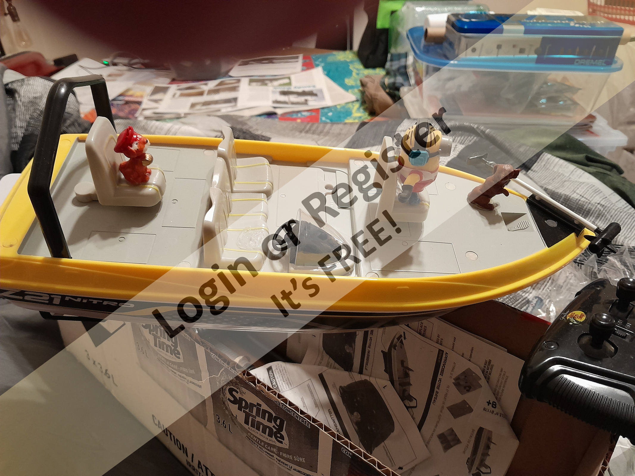

What is that orange thing sticking out of the bottom of the SPECTRUM tx??
For young kids i buy the $60 BASS PRO boat that uses 6-AAs, has a 2-stick controller which has spring-loaded throttle & rudder sticks & differential steering.

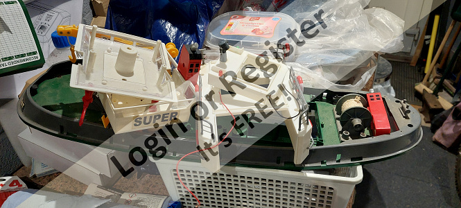

I'm sure that's what it was called 10 yrs ago! We had one for my young kids, then sold it as they grew up. So now my 3 yr old grandson is asking for a boat😀
His birthday is next month, and at that age too clumsy for a proper model boat, by pure luck one of these tugs came up on fb for £40, it was local, so I got it. I've stropped it down, it's had a life!, but motor runs (very small!) I've got the rudder thing working and the hydrant pump that wasn't working now is👍
