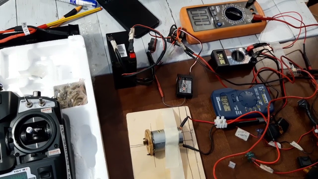

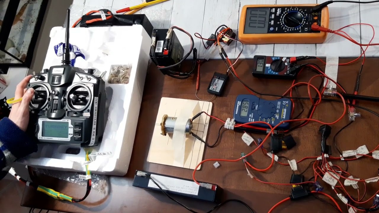

REFERENCE AND EXPLANATION OF THE VIDEOS
In all the videos you can see the test of the two relay circuit.
You may notice that there are three multimeter testers.
The first blue tester on the left is used as a voltmeter (see the diagram in the sixth image).
It is connected directly to the motor so it will detect the voltage that reaches it. Just by looking at this instrument we will be able to understand which circuit we are using.
From the number of volts we will understand (as well as from the obvious change in engine speed) which circuit is working, at 6 or 12 volts.
The center tester, black in color, is used as an ammeter and is in series in the six volt circuit (immediately at the ESC output). It detects the sum of the currents flowing in the esc/motor circuit plus the small current flowing in the coil.
Blue/black arrow and blue/red arrow of the two relay circuit.
The larger yellow tester on the right is used as an ammeter and is placed in series on the 12-volt battery circuit.
In the videos you can see that the remote control lever is gradually moved forward.
At the same time you can observe the gradual increase in voltage on the blue tester.
At the same time you can see the current rising on the black tester.
Instead, on the yellow tester the display shows 0 Amperes, a clear sign that the 12 volt circuit is open and therefore not active.
As soon as the voltage, measured on the blue tester, exceeds a certain threshold, we see that:
the 12 volt motor starts to turn much faster,
the blue tester directly indicates just under 12 volts,
the black tester shows a few milliamps (not zero) because it continues to detect only the current of the coil circuit (current no longer flows in the ESC circuit),
the yellow tester measures the absorption of the current passing through the 12 volt circuit.
I made more videos to show you how, as I added diodes, the voltage drop increased.
In this way you can see how the activation threshold of the coil goes from 3.61 volts in the first video to 4.29 in the last video.
I could have continued to increase the voltage drop up to the maximum threshold but I stopped because I believe that this way the concept is understood well.
In the last video you can see the reverse gear being activated.
The blue tester shows negative voltage.
The black tester shows a reverse current.
The twelve volt circuit which is only fast forward never engages (and thank goodness!)

If any of you know other systems that are not mere mechanical switching (for example a winch that acts on the rotary knob of a voltage variator) I would be happy to know them.
In the next message I will explain how this simple scheme works for those who are interested and don't know.
I don't want to load too much information into a single message which then becomes difficult to read.
I hope this may interest you.
