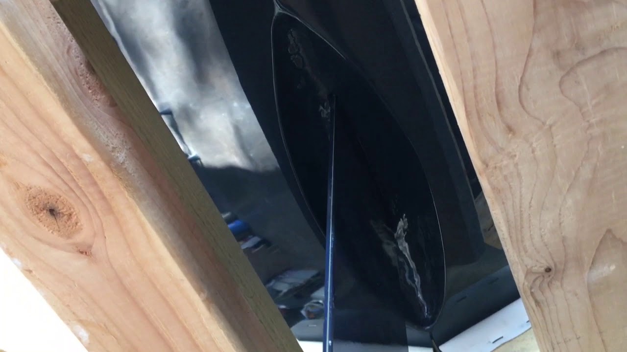

Hull has fibreglass on exterior surfaces including rudder and skeg.
Decks have been fitted but will not be installed until after the installation of the RC components.
Lots of other parts to be made yet.
